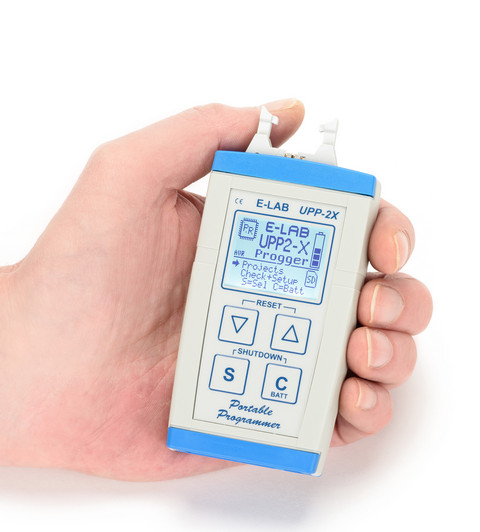

The Versatile:
UPP2-X accu portable ISP programmer
Portable Programmer for InCircuit programming
USB version - JTAG, SPI, TPI, UPDI and PDI modes
  • Supports all SPI, JTAG, PDI, UPDI and TPI programmable AVRs
  • Supports XMegas in PDI mode
  • Supports Tinys in TPI and UPDI mode
  • Supports all SPI programmable AT89Sxx, AT89LSxx and AT89LPxx types
  • Supports the TI/ChipCon CC1110, CC2510 and CC2430 family
  • Connection to the PC through USB
  • NEW with more robust USB-C socket.
  • No powersupply necessary. The unit is powered direct from the USB port of the PC or the target or the internal battery
  • Internal Li-Po battery with 3.7V/900mAh.
  • Adapts automatical to the targets voltage (1.7-5.5Volt ca. 30mA)
  • Programmer can supply the target with a variable voltage, from USB 1.7 to 5.2Volts, 30..300mA
  • Easy and extensive software
  • Software runs under XP, Vista and Windows7, Windows10, 32 and 64Bit
  • Small, light weight and handy unit 115x55x20mm
  • Packed projects can be stored from PC into the programmers MiniSD card.
  • Projects can be stored into the microSD card via the PC's card reader.
  • Upto 63 projects on the flash card can be handled.
  • Programmer can be moved from target to target w/o PC connection or interaction.
  • Project oriented.
  • Power supply and microSD flash card included
Advantages of the UPP2-X
  • UPP2-X doesn't need any adapter for PDI programming !
  • Can process AES encrypted projects with the tool PackProg.exe and also directly from its SD card
  • programs 128kB flash (full mega128 with JTAG) in 3..4sec
  • absolutely portable
  • upto 64 projects and directories (folders)
  • comprehensive user interface
  • 108*64 Graphic LCD
  • predestinated for repair stations and field service
